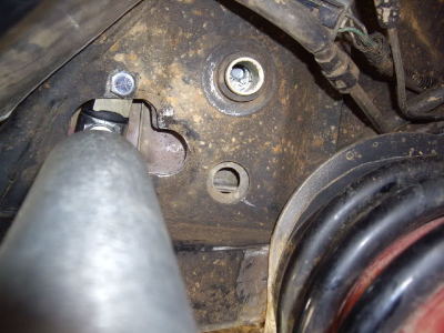

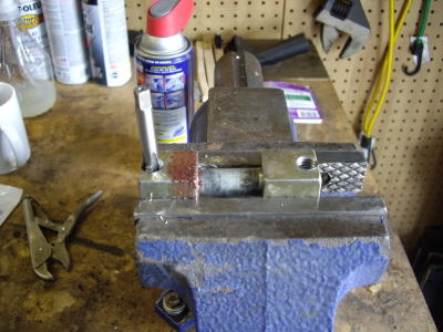

So as I sat there disgusted thinking through my options and staring at the jeep two options came to mind. One replace my new Bilstiens...not so much. Two find some way to eak another inch or so out of the existing mounting location. Looking at the upper mount I noticed there is a about two-three inches of clearance between the body and cross member. I took the shock off and found the angle of the dangle to get the bar pin above the the cross member and wouldn't you know it, I could get an inch and half of up travel in this configuration. The shock mounting location would now be even with the top of the frame. Now how to mount it, I went digging through my bin of brackets and found my old JKS bar pin eliminators that I had used two sets of shocks ago. I ran up to Autozone and picked up a set of urethane shock bushings and set work installing them. Once I had the bar pin in place the issue of securing them came up. I decided a nut and bolt would be too much of a PITA and would also make removing them later even more of a PITA. I dug out a 7/16 tap and threaded the mounting holes in the BPEs this way they could be bolted from the bottom up through the cross member.

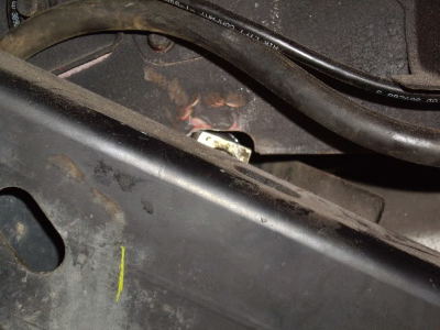

So now the issue of removing the welded nuts on top of the cross member, body bolts come out and up goes the body, and yes it was a PITA getting them out. I used a hole saw to cut the clearance required to get the installed BPE in place, the angle in through the cut hole and then clock over to the mounting holes, again to make removal possible without lifting body again.
The end result is up travel increased from 2.25 to 3.75...and should give me just enough to prevent bottoming out.
