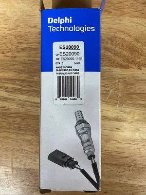

Jeep fixed. Replaced the O2 sensor. Here is the part.
It was pretty easy. That specific sensor was easily accessible from under the vehicle. Cleared the code and went for a drive to see if the code came back. No code. Then used the Jeep to go get a load of concrete block. Still no code. Good to go. Still doing the spit & sputter game on hot start. I'll hunt down a zero ethanol station and try that next. Pretty sure I saw one down the road.
