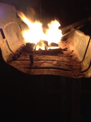

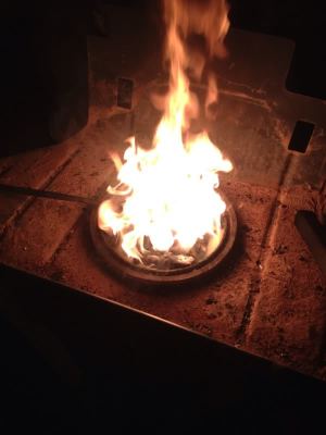

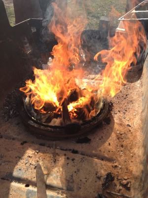

Made a brake drum forge out of a Dana 35 drum and old gas tank skid from a TJ I had laying around. Turned out pretty good. Burning coal and using a blow dryer to add air. Got to dark to do much but I messed around for a while with it.
Heat up metal duh!

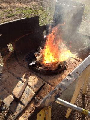

got any more pics of this brake drum forge? did you have a mount for the hair drier?
I've got a large gas burner probably 8" in diameter with a "bazillion" nipples on it similiar to this one. Thought about seeing if I could do something with it.

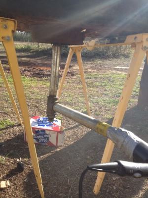

I'll try and get better pics of it in daylight. I'm using a hair dryer now but will replace it with a bath fan, from there it goes into 1.25" galvanized pipe (I know I know, it's all lowes had) to a black iron T coupler. One end has a plug in it so I can easily dump it, other end has another section of 1.25" that has a cap with holes in it that sits in the drum. I cut out a circle from the scrap I cut from the skid that sits on bottom of drum and has a hole where the pipe comes up and they are all welded together. The drum sits in the whole of the skid pretty close to flush.
Idk if that makes sense trying to describe it. Google or YouTube brake drum forge and you'll see what I mean. I have next to nothing in it. Most was laying around just had to get the pipe. Could be built for less then $40 probably. I picked up a 14 bolt drum I was going to use but decided it may be to big I might use it for another one if I decide the forge I built is to small.

Here you can see underneath the pot. Going to pick up a bathroom fan tomorrow as the hair dryer sucks

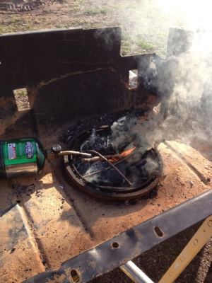

Takes a little bit to light. Breaking the coal up significantly helps tho.
