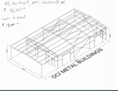

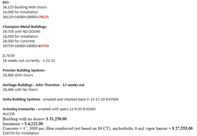

I priced red iron buildings from 5 suppliers in late 2020. But many of them were just that suppliers and did not offer installation.
here were the prices I got.
40x80 with 40x60 inclosed and the other 20x40 open under the gable with one side wall.

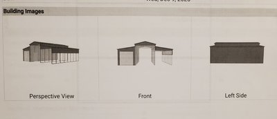

Shewww. I reckon im stuck with wood construction because of the whole HOA deal. Gotta match the house. Id like to do a 24x28 with a lean too off the back. Double door on both ends so when im wrenching i can park in the middle and have plenty of space. I want a good work bench, and a space to keep Lexus and sea doo inside. Keep rzr under lean too with firewood, and keep explorer, acura, under house in that garage. Golfcart lives under porch. Id also like a bar on the back of the garage. I wish i had a place to stash camper at house but its not in the cards. We really like our neighborhood and our yard just not set up for it. Its hilly and the driveway is tight.
Something like this. This at least has an attic, but wouldnt hate having a room up there.

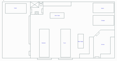

Yeah, but if I did this I would have the spot labeled vehicle prepped for a lift. That starts the conversation of, would I then move tools, welder, etc over too...? I'd have to have decent electrical service run anyway for the camper hookup, so welder wouldn't be an issue. Then I'd want insulated and climate controlled :sick:
#20

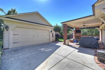

Also thinking the best place for it would be facing my current garage doors at the other end of the pad. That way, not having plumbing/bathroom wouldn't be an issue because you could just walk across pad to current garage bath.
