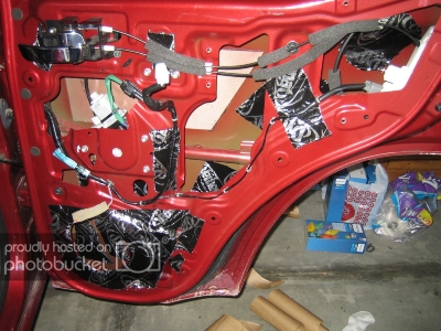

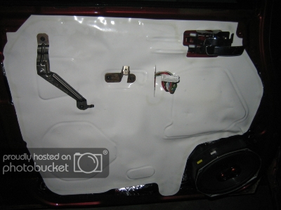

So, with this in mind, I removed my door panels and went to work. This was significantly more involved than just swapping speakers because not only did I have to remove the door panel, I needed to remove the vapor barrier. Before removing the vapor barrier, I needed to remove the panel mounts that were screwed into the inner door skin.
You can see the two metal support struts used to secure the arm rest in that photo. They are the metal pieces immediately left of the wiring harness. If just installing pictures, this is as far as you need to go in regards to disassembly.

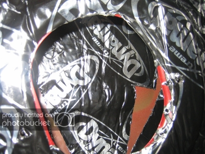

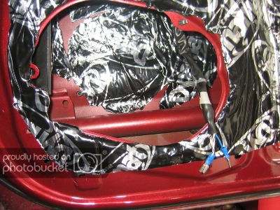

In addition to being used to dampen the vibrations of the metal, it can also “reflect” sound and keep it where it is supposed to be. To do this, all I did was put some on the outer door skin right behind the speaker opening, shown in the pictures below.
You can also notice in those pictures that I applied Dynamat heavily around the speaker openings, being that this location will be a strong source of vibrations.

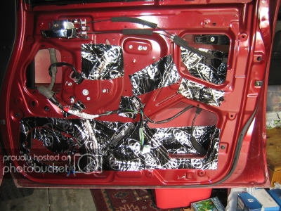

Below are shots of the doors after I applied the Dynamat to the rest of the inner and outer door skin. I followed Dynamat’s recommendation and tapped the metal with the butt of a screwdriver and where I could hear a “tinny” sound I would apply a small patch of it. After tapping around and hearing nothing but solid “thuds,” I put the speakers in and the door panel back on. Also, Nissan was kind enough to have already installed a dampener from the factory. It is the pinkish thing attached to the outer door skin in the pictures below.
