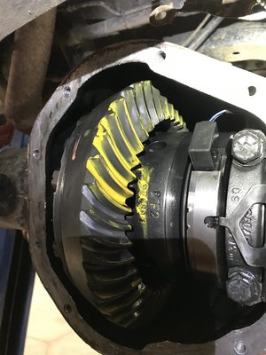

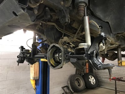

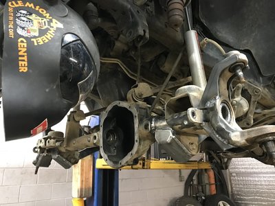

Just finished up Barnes tube sleeves, C gussets, and lower control arm skids. It is highly recommended to change the ball joints after welding the C gussets on, so we installed new moog ball joints as well. We also helped the 3.8 in the Jeep with some new motive 5.13 gears. All the work was performed on a 2008 Jeep jk rubicon.

I need to do control arm skids on mine. They are getting beat up pretty bad. Hey Cole, maybe you can go pull the pics of the project you did on mine and put it up. If you have time.
#6
Got a friend that ask me to weld c gussets on his J.K. I’ll tell him about the ball joints. Good info thanks.
No problem glad I could help.
I can do that if my old phone will reboot. I think I still have a ton of those pictures

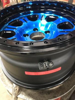

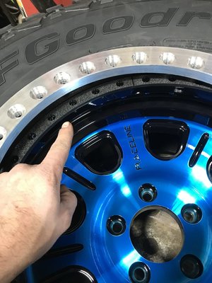

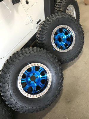

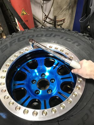

Mounted 5 Raceline monster beadlocks today for a Jeep Jk. Paired with 35x12.50R17 BFG km3

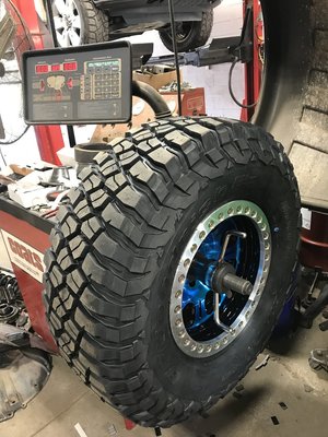

Installed tpms sensors

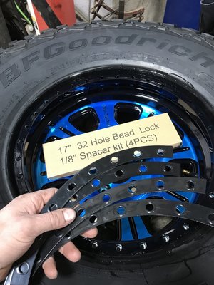

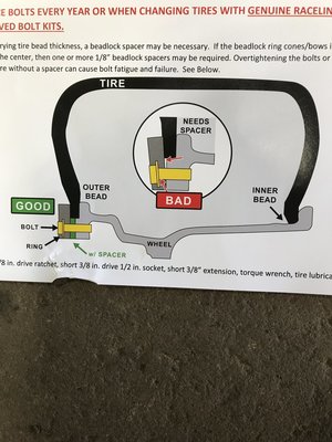

Some tire manufacturers have thicker beads than others, so Raceline now sells ring spacers to prevent bolt failures.
Also balanced them
