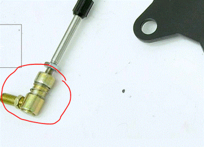

Think I'm going to order the Savvy one. @Fenrir what problems did you have?
@97TJGUZZY Don't do the Savvy that whole experience soured me to that entire brand. Go with the Novak. The ball piece that connects to the transmission linkage is garbage on the savvy. Broke immediately on the first pull. Couldn't get Savvy support to help at all. Got in touch with Novak as they looked very similar. Apparently Savvy ripped off their design and they actually sent me the replacement part I needed for FREE. Go with Novak.
#9
Supposedly the Savvy kit includes a longer cable and a better bracket to bolt to the tub. Its also a little cheaper. There have been people with the same story about the novak ball piece.
#11
did you buy your savvy directly from them? or on amazon?
#16
Mine didn't have any slop and after I swapped the part in from Novak its been great. But it broke immediately after I got it installed just pulling up on the transfer case selector.
#18
I took a chance on the savvy unit because I had the amazon rewards. I have read enough good reviews that I'm willing to chance it for free. I'll update with my results.
