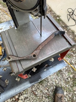

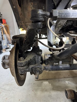

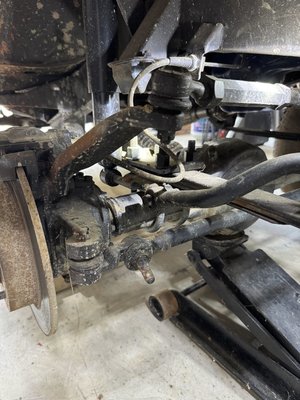

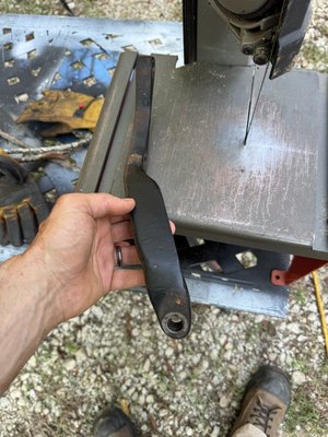

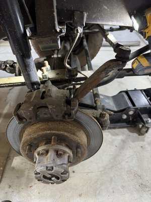

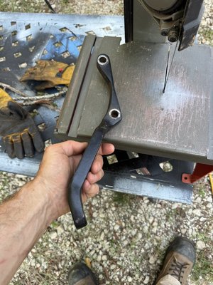

Went to measure the high steer arm this morning because I’m not getting full steering. The stock pitman arm is 5.5” so I figured I needed to be somewhere in that range. Stock tie rod mount location is around 5.5-6” from trunion to mount point. The fabricated high steer arm the previous owner made was 8.5”!!!! That’s why I wasn’t getting full steering. I checked the metal and it looks to be 3/4” plate steel that was cut and welded, so I chopped 2.5” out of it and beveled the ends and welded that baby back up. Taking a breakfast break but we will see how it does.
Here are the before pics.
