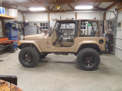

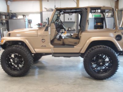

This all started with a Christmas present from my awsome wife. She surprised me with this 2000 tj.
This is the specs when I got it.
I think its about 5.5 inches of lift via 4" springs and adjustable coil spacers in the front and srings and spacers in the rear.
36x15.5 Baja MTZ's on 20"Fuel Hostage wheels.
G2 Dana 44 front axle with 456 gears and an OX locker
Stock dana 35 in the rear
Smitty Built front and rear bumpers.

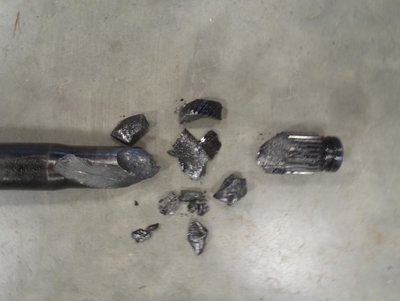

Well this is my first build so I've already made some mistakes. Thats why I started this thread, so let the input and constructive critisism fly. My first mod was to regear the rear axle, but when I opened it up the spider gears were shot. So I put a Detroit Locker in it. Well you probaly know what happened next, yep broken axle shaft.
So I put in some chromoly shafts and got some junk yard shafts for spares until I can fit an 8.8 in to the budget.

Sold the 20's and got some 35x12.5 and Craiger soft 8's.
SYE kit and CV drive shaft.
Warn 8000# winch.
This is how it sits now.
Warn 8000# winch.
